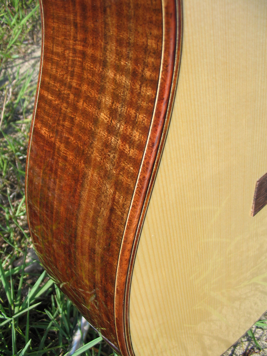

The bindings were cut from the same stock as the sides(read my little rant in the walnut auction thread <bg>). To make them look a bit different, just reverse the grain's direction. Use runout to your advantage! As you turn this guitar, when the side looks dark, the bindings appear lighter, when the sides look lighter, the bindings look darker. Juts like runout does to a top...
Subtle can be so cool....
PostPosted: Tue Apr 25, 2006 3:24 am
Posts: 908
Up close.
PostPosted: Tue Apr 25, 2006 3:46 am
Posts: 244
Mario,
Dang that looks good.

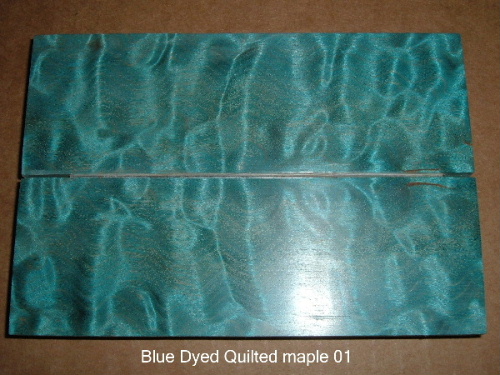

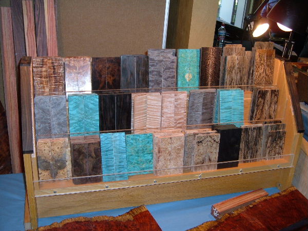

This evening while out harvesting a maple burl from a front yard in town the thought occurred to me there might be a need for dyed curly maple , curly ash or whatever for binding stock. I'm already set up with all the right equipment, autoclave with diffusion vacuum pump, pressure chamber, etc for the acrylic impregnated processing I do. I've never been into making binding stock, but the dyed stuff is intriguing if there's a need to be filled. Any advice or comments appreciated.
PostPosted: Tue Apr 25, 2006 3:58 pm
Posts: 908
Larry, for sure, there's a market, -IF- the color is completely through. It's the only way it will work. Not only bindings, but flame mapled, purflings, rosettes, knife handles, inlay pieces, etc.... If you can dye completely through in vivid colors, wow, the possibilities are endless.
I'm rather fussy with my flame maple bindings, as I like them bookmatched, and the flame really tight, but not overly consistent(a bit of inconsistency adds to the look, where 'perfect' figure gets boring on such a little piece). Therefor, I like making my own, and am well setup for it. What I'd love to do is provide you with bindings, sized and numbered, and have them dyed. I'd expect pay the same for the service as I would for completed bindings.
But only if the dye goes completely through....
PostPosted: Wed Apr 26, 2006 1:31 am
Posts: 600
I'm not thinking individual binding pieces, but "blanks" .375 or .5"x1" wide or so. The luthier can rip his own from that stock.
No problem on the dye process as I've done it for years for my knife handle products.
PostPosted: Wed Apr 26, 2006 1:49 am
Posts: 290
That's beautiful - I see electric guitar body caps...
PostPosted: Wed Apr 26, 2006 2:11 am
Posts: 908
Way cool.
Yes, a 'slice your own' would work well.
